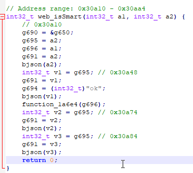

I've decompiled the hdrv_p1 binary, and I came across the following
isSmart web check
isSmart web check
isSmart web check.png (6.99 KiB) Viewed 13709 times
The name of the function suggest that Toon checks with Quby/Eneco if the reported meter (with it's serial number) is a smart meter (mine is not, otherwhise this project didn't exist)
I'll try to do a man in the middle attack on my Toon to verify this :P
