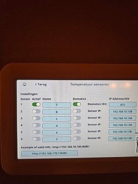

Hi ,
after the last update I no longer get any info from my domoticz temp sensor but only get a value of -99
which seems to indicate ToonTemp cannot reach my Domoticz installation. Prior to the update all worked just fine.
Any ideas on this? Is there something I need to change? Also , the new update uses a JSON API if I am correct? But how to code the Domoticz URL?
Does it still need the port coded?
Any help would be much appreciated!
Update: I installed the latest version of Domoticz ( 2024.1) and the Temp shows again, although its value is shown with a very small font size .
oepi-loepi
Posts: 683
Re: toonTemp : show external Temperature sensors on toon
Post by oepi-loepi »
You were using a very old domoticz with an old endpoint.
The fontsize is set to fit the complete text on a tile. So if the title is long, the fontsize will be smaller.
Dapper
Posts: 3
Joined: Mon Jan 08, 2024 1:01 pm
Post by Dapper »
Hi Oepi,
thanks for the response but I believe my case to be different.
aqttached are 2 pictures, one showing the definition , the other showing the very small font size :
oepi-loepi
Posts: 683
This is the main tile which will show all toonTemps on 1 tile so small font. You can select another tile from the temperatuur section after you have clickeed an empty tile
Dapper
Posts: 3
Post by Dapper »
Oops my fault.
Thanks a lot Oepie-Loepie, that did the trick!!!
