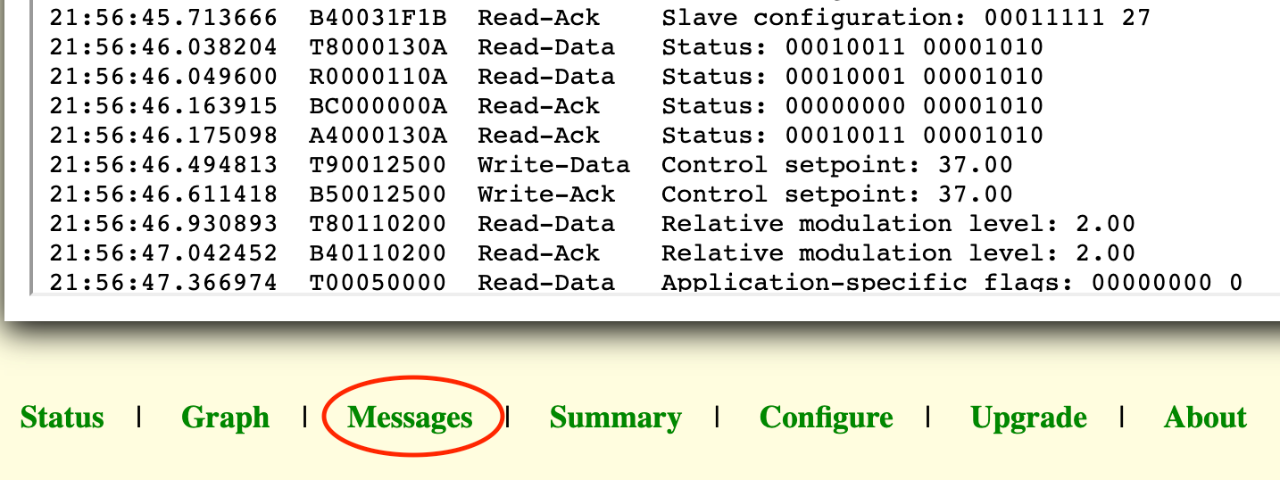

I want to ask my question again, do you see a stream (log) of messages in "Messages" tab of otmonitor?
Screenshot 2023-01-22 at 21.57.00.png (216.82 KiB) Viewed 7283 times
If it is OK then check broker log for connection, looks like something wrong with your setup.

Yes, I see the messages in the Messages tab.
