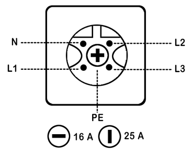

Below is the Perilex, What is I did is:
  • Replaced the Perilix outlet with a normal outlet and only connected Brown (L1), Blue (N) and Green(PE) (so normal 230 volt settings)
  • Removed the the connector from the Home ventilator 230 volts cable
  • Cut away all the smaller cables (other colors) except for the Brown (L), Blue (N) and Green one :)
  • Apply a normal 230 volt connector to the cable
This applies for the ITHO ECO-Fan, I'm not sure if it applies for all other Fans.
But for all other (non wireless controlled) ventilators this modification is not an option, otherwise how are you controlling it :D
Perilex om Wiki http://nl.wikipedia.org/wiki/Perilex
Perilex diagram
Perilex diagram
