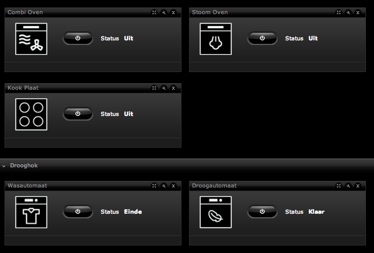

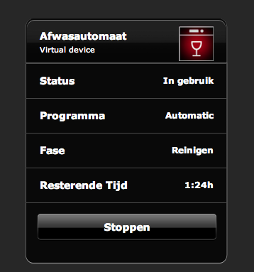

So well since i dumped homeseer and went playing with fibaro.. i actually did something with my miele stuff now..
See the results:
When a device is turned on:
Screenshot 2014-03-19 21.08.40.png (27.41 KiB) Viewed 29870 times
Overview of all my devices connected and the status from top view:
Screenshot 2014-03-29 19.53.38.png (43.25 KiB) Viewed 29870 times

When a device is "active" and actually doing something, the icon turns into a red'ish icon.
So i must say it looks good and it works correctly now. Took my time to get a finished solution but its done ;)
