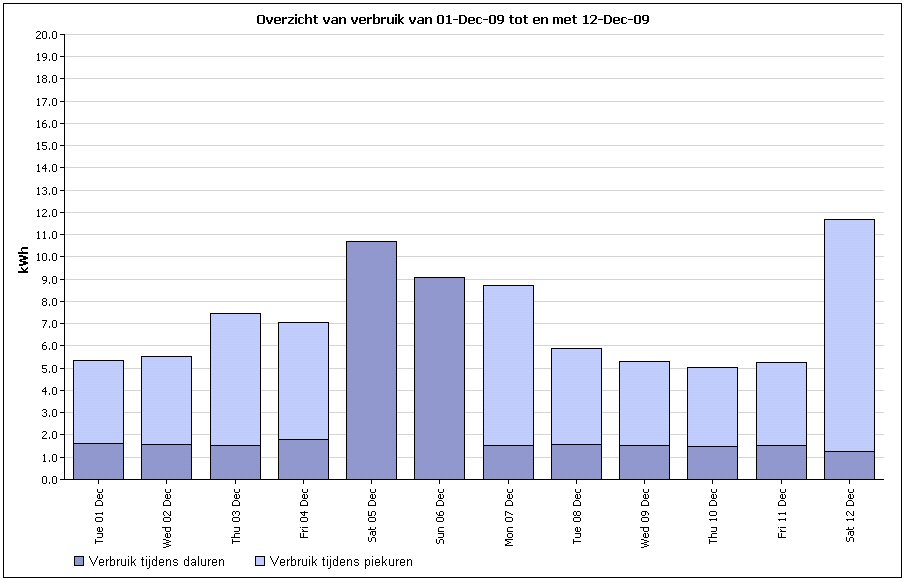

Hmm, seems that something funny is going on. While I thought that the dual tariff issue was solved, it looks like it's behaving pretty odd:
While it shows last weekends usage correctly (Both the entire Saturday as well as Sunday listed as using the lower tariff), for today (Saturday) it shows a mix of low and high.

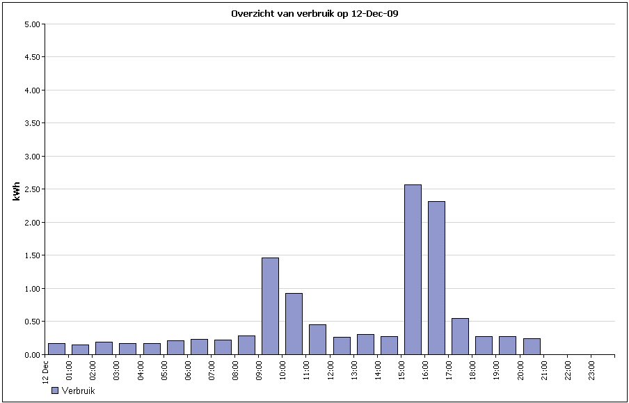

The daily usage shows things correctly:

Can somebody explain this to me?
