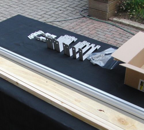

Nuts, bolts, wood, kabels, everything is included to installed the system

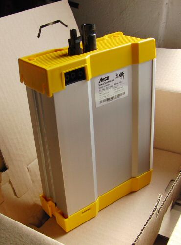

The converter. It's an very easy system. Just plug in the wires from the solors panels and the 220V plug in a free mains contact. The converter can handle max 625 Wp. If you need more then just plug another one to the side of it (snap together) and you double the rating. This can go up as high as 3500 KW. Each unit is reasonable prices and most important if one goes down then the rest of your system still will produce power :D

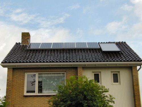

The present situation. I still have room for 9 panels on this side but first i have to do some saving again.

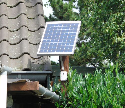

This is my first solar system. It charges a car batterij. You can see the light sensor (KaKu) underneat the panel. That will switch the LED garden lights on for 2 hours after sunset. The whole system worked flawless throughout the whole dark winter. This way i don't mind to turn on the garden lights. :D

The positive point of multiple inverters is that if one goes down the rest of the system will produce power.
The negative point of multiple inverters is the fact the inversion is not as efficient as with one inverter. Furthermore the MTBF of my inverter is 187000 (> 21 years).

At the moment my six panels are producing 1KW energy and i took a look in the utility cupboard and saw the meter running backwards...! :D
I just now realized the following. I have a old ferrarismeter, one with a revolving disk in it, and it's a double tarif meter too.
The day tarif is the most expensive tarif and that i am not using that now. Even better, i am eating away of the used count. While in the evening when the panels aren't producing anything anymore i start using power from themain grid but at a lower rate then i pumped in previously.
I am doing 'saldering' on my own now, no administration costs and no extra 'smart' meter costs. :P
