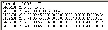

Examples for pincode 1234
disarm
0d a1 00 00 00 12 34 00 00 00 00 00 43 d4 0a
arm away
0d a1 00 00 05 12 34 00 00 00 00 00 43 cf 0a
You will get a ack from the panel
0d 02 43 ba 0a

This is the sequence of a disarm with the wrong pincode (using my code)
2011-08-05 11:37:15 0d a1 00 00 00 12 34 00 00 00 00 00 43 d4 0a - OUT
2011-08-05 11:37:15 0d 02 43 ba 0a - C_OK - IN
2011-08-05 11:37:15 0d 08 43 b4 0a - C_OK - IN
2011-08-05 11:37:15 0d 02 fd 0a - OUT
I do not ack an ack and the Powermax seems happy with that :-) but I do ack error '8'

Hi Utz,
In case of correct pincode you only get an ack (2)
In case of a wrong pincode you get an ack(2) followed by (8)
