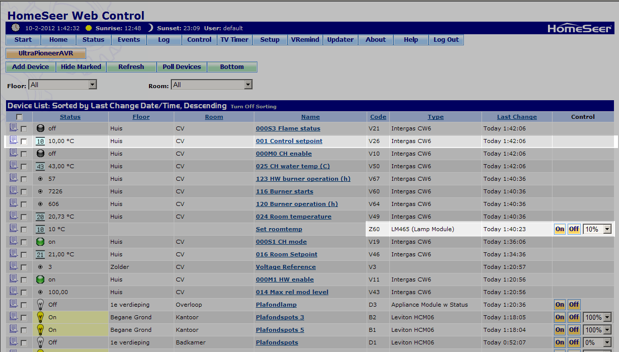

Bwired wrote:nice project Fabian!
It sure is, thanks to http://tclcode.com/opentherm/ and blb for the HS scripts.
My Intergas boiler is causing me headaches too. Its OpenTherm implementaion differs a bit from Remeha's which seems to be causing errors in the gateway while the burner or pump is running.
Is it possible to create a virtual device with a range of possible values 10 , 10.5 , 11 , 11.5 .... 25 ?
