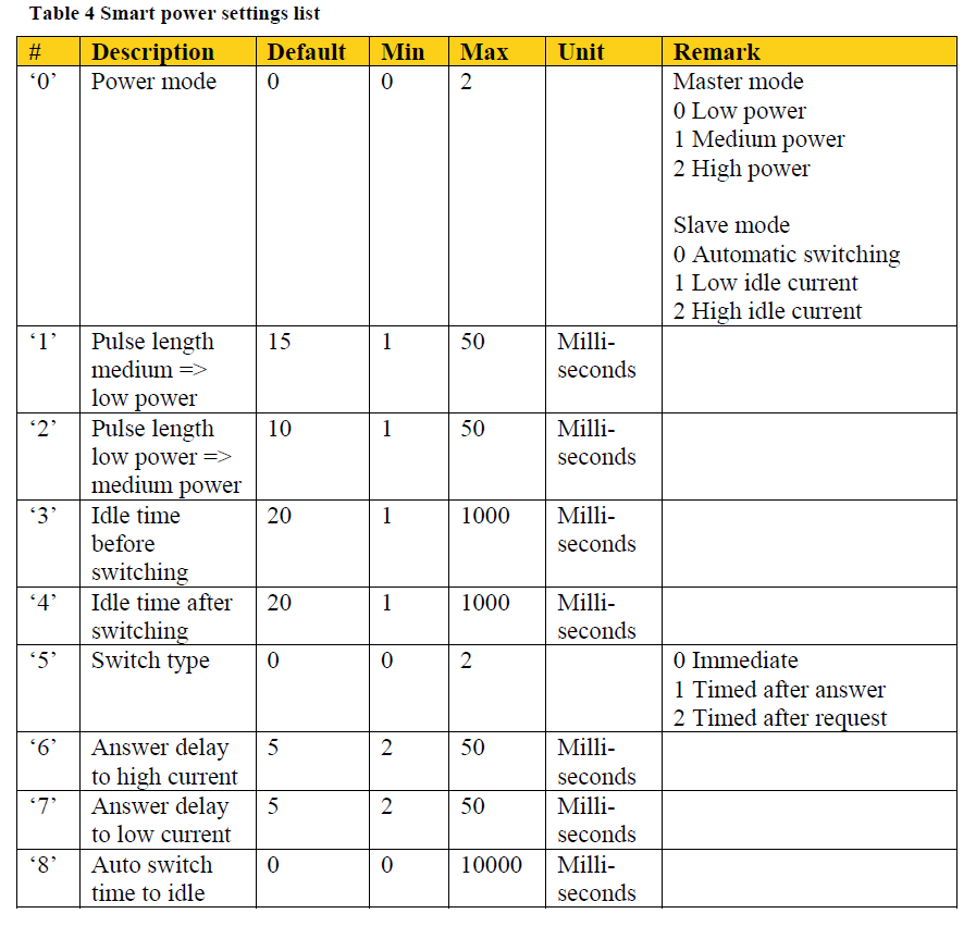

hvxl wrote:Interesting, but not really what I would call a specification.
My current understanding is that ID2:HB0 indicates that the thermostat would like to be able to use smart power at some point in the future. I presume the boiler will clear this bit in its response if it doesn't support the feature. To actually switch to a higher power level, the thermostat makes the line high for some amount of time. A high level for 10ms seems to signify a switch from low->medium power. And I see a high level of 15ms for a medium->low power switch. The thermostat will need to keep the line at the logical 1 level for high power.
What I would like to know are the exact allowed timings. Is anything below 12.5ms low->medium? And after how much time should the gateway conclude that a line that remains high means low->high, rather than low->medium? Is the duration of the high level actually significant or is any high level of around 10-15ms simply a switch between low and medium power levels?
Are the timings in this table any good? They are allowed Smartpower settings used with the OpenTherm TestTool.
Honeywell Functional specification OpenTherm TestTool V2.4
OT Smartpower settings.png (73.37 KiB) Viewed 11285 times
Posts: 2035
Re: Opentherm Gateway 4.0 alpha/beta testers wanted
That was one puzzle-piece I used to be able to come up with something that had a chance of handling smart power. From that starting point it still took a lot of experimentation to actually make it work.
But thanks for keeping your eyes open for any shred of information on this subject.
