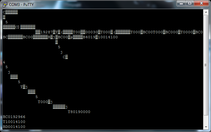

Firmware 4.1 won't run properly for me. After the update through otmonitor I was unable to get a proper output from the UART. I've reverted back to 4.0.1 which is working fine.
With firmware 4.1, my OTGW was talking some garbage. Just once it learned to talk properly again (see screenshot). But most of the time it kept outputting garbage. I am connected through USB.
Has anyone else successfully updated to 4.1? What might have gone wrong for me here?
