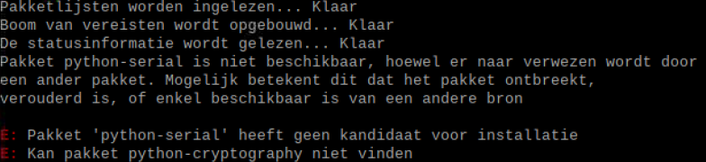

However when trying to root another Toon Uboot R6, i get the following error messages when using the automated script:
E: Pakket 'python-serial' does not have a candidate for install
E: Can't find packet python-cryptography n
Has anyone encountered these error messages and found a solution?
PS: I run the latest Raspberry Pi OS and have performed sudo apt upgrade & update before running the script
error messages
error messages
Schermafbeelding 2022-03-18 091428.png (80.01 KiB) Viewed 7951 times
TheHogNL
Posts: 2125
Re: Fully automated rooting script
Post by TheHogNL »
ferryperry wrote:After my first successful use of the automatic script, I manage to root my Toon Uboot R8.
If it worked before it should still work. But maybe new installation of your Pi? If so, did you forgot 'sudo apt install python-serial python-cryptography' ?
steffie
Posts: 10
Joined: Fri Apr 01, 2022 3:24 pm
Post by steffie »
I am running into the same problem with the python-serial and python-cryptography.
Perhaps due to the fact that in the new Pi Images python3 is now default?
Any suggestions on how to get it fixed? :)
