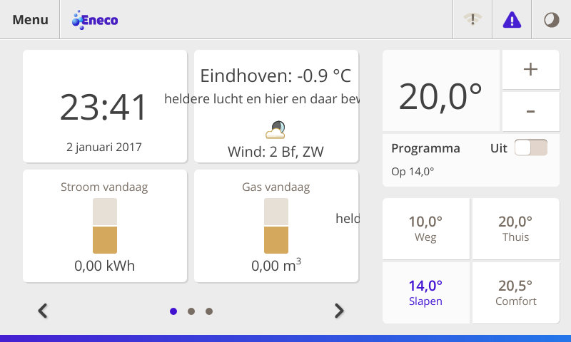

Hmm, maybe adding the text for the weather type is not always a good idea ;-) :
(never mind the colour map, it's a frame buffer dump, converted to a jpeg in the GIMP, RGB should be reversed to BGR).

marcelr wrote:Hmm, maybe adding the text for the weather type is not always a good idea ;-)
funny, it has only been 'Bewolkt' here since I started....
I now truncated the string if longer then 21 characters, your example now showing as 'heldere lucht en hier...""
Will be included in the next upload.
Thanks for flagging.
