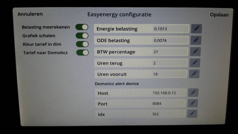

But the Easy Energy app; has functionality inside to setup a Domoticz IDX.
No additional scripts / cron's etc needed.
i think it's better to Push data rather then to Pull every 5 minutes or so.
see attachment

That it possible as well, however, whether I push to Domoticz or Domoticz pulls from me doesn't make a big difference.
Advantage of the latter is that other applications could pull the data as well. Seems more flexible from my end to avoid building interfaces to multiple home automation systems.
