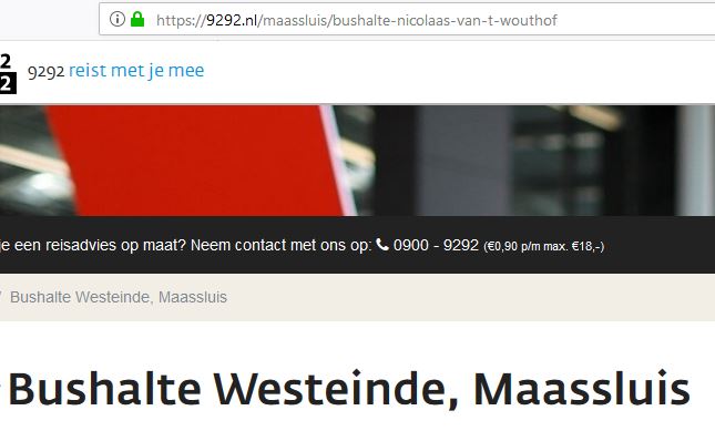

Great App, works fine whit Mi-light on Domoticz! I had trouble to get the OV information: there is a different between the busstation name and the ID: the busstation name is Westeinde what didn't work. On de site http://www.ov9292.nl i discovered the proper ID in the URL. Maybe more stations has the same issue.
bushalte ID
bushalte ID
bushalte westeinde.JPG (40.1 KiB) Viewed 12411 times
