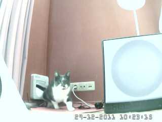

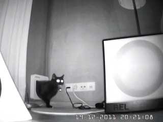

I don't need to restrict my cats but want to know if they come in or out. For that I have an optical proximity sensor (IR-Led and photocell in one housing) that I will mount on the end of the tunnel. Then check what gets triggered first to determine the direction.
At the moment we also have a 'catcam' that triggers on movement and sends an email with two pictures + recording of 2 secs of the movement.
Now we know who is in or out and who brought in the mouse or moll :-)
Here is a day and night pic:
