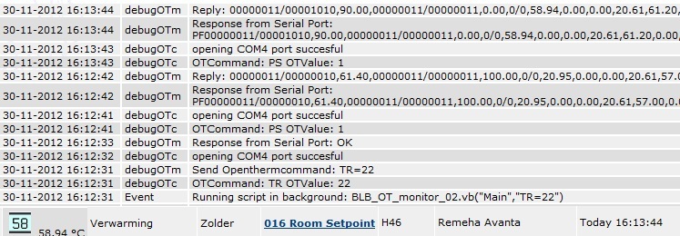

I've the Remha Avanta with a iSense thermostat. When I send the TR=22 or TR=21 command, the room setpoint changed to 59 degrees....
Other commands like 20, 19, nothing happend. On the iSense the 59 degrees is also visble. I can only change the room setpoint therafter with the iSense.
The OT=outside command is send succesfully and visible on the iSense in the correct degrees.
The TemporaryTemperature device is changed to the correct temperature.
- roomsetpoint.jpg (113.33 KiB) Viewed 19206 times
