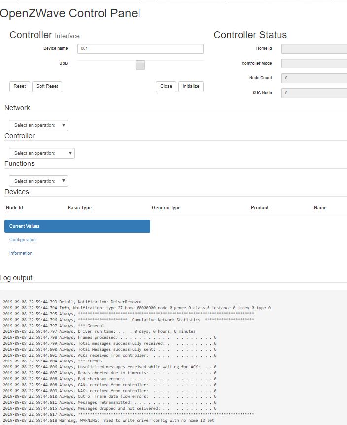

Yes, that works. It's just that I didn't yet figure out how to actually use it ;)
The page is empty with regards to values when I've started it. I found an device ID database that says quby is 0001.
When I enter it, and initialize, I get errors and some emtpy value's as shown in the attached screenshot.
Since I don't know what I'm doing, I created a config dir where I put this file since ozwcp complains about no config found
(https://raw.githubusercontent.com/OpenZ ... by/qb2.xml)
But that doesn't work so I'll have to educate myself on the topic unless it should work right away when installed ?
Since it doesn't or I need to configure something that I haven't yet, idk.
