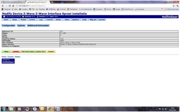

I do have a similar problem. If you check the log you will find that only the root device changes status if you press the connected switch. But to control the device from homeseer you have to switch the child instance 1. Problem is that the status of this instance will not be updated in homeseer.
So to check the status just check on the root device and to control just set child instance 1 on or off.

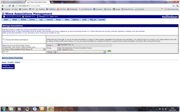

@reiniertc: Just found out that if you only associate group 1 to homeseer all works fine. Also deleted switch 2 which is useless and all works as expected.

Henk_J wrote:@reiniertc: Just found out that if you only associate group 1 to homeseer all works fine. Also deleted switch 2 which is useless and all works as expected.
Thanks Henk_J.
Somehow the root device doesn't change status either. it just stays "no status", regardless of the status of switch 1.
I've changed association to group 1, but my problem remains the same...

Hmm strange. I've included the homeseer screen for the root device and chils 1 instance.
