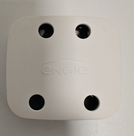

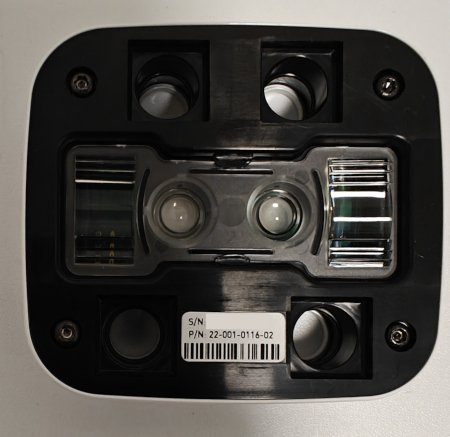

I recently rooted my Engie Boxx (Belgian Toon version - see pictures) and my electricity meter doesn't light blue as before anymore.
I'm not sure it is related to the rooting. If yes, what should be done to revive it?
Otherwise, does someone knows where to buy a replacement? (Can't find any on Ebay)
Thanks.
Bernas
Joined: Wed Jun 05, 2024 11:53 am
Re: Hardware: Toon metering module, "meteradapter"
Post by Bernas »
If the problem occurred after rooting, it may be related to the software settings. If you are not sure if the problem is root related, can you try resetting Engie Boxx to factory settings and see if the blue light returns?
