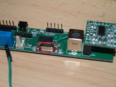

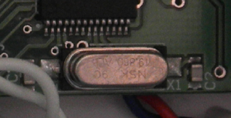

My PCB seems to have a different clock frequency than Andi's.
Can you tell me what is written on the metal component below the PIC? See attached picture of Andi's board and my board.
Andi's is 19,66 (MHz) but mine has 19,860 (MHz) written on it. The firmware needs to be compiled for the frequency of your board.
xtal at 19,860 MHz

Hi Darwusch
My old (defect) board (Pet Porte 2009 Smart Flap Iss E) has a xtal AEL19.66 07/10
My new board (Pet Porte 100-1023 rev x6) has a christal A196H07

Post by Bastiaan »
My new one: 196G07 my old one: 19.66 SCA

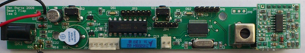

Now I received an Iss D from Petporte. It has the same frequency as Iss C and it worked with original firmware with my flap.
I then tested Andi's firmware on Iss D but it didn't work, strange behaviour and not possible to program an rfid chip. Also I recompiled the firmware with the frequency of my flap, but same result.
Andi's firmware was made for Iss E.
I noticed that Iss C, D and E have all minor differences in the layout or the components on the boards. See attached pictures.

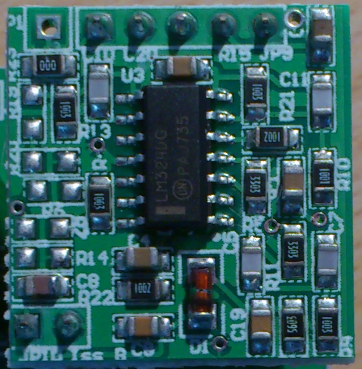

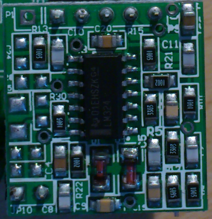

Iss E has resistance R25 placed near the xtal in stead of under the Rx board, and also the Rx boards are different.
Rx boards back Iss D and E

Rx board Iss D-E back.jpg (91.33 KiB) Viewed 34576 times
Rx board Iss E
Rx board Iss E
Rx board Iss E.jpg (240.24 KiB) Viewed 34576 times
Rx board Iss D
Rx board Iss D
Rx board Iss D.jpg (257.85 KiB) Viewed 34576 times

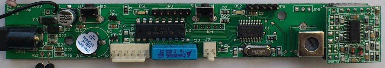

PCB Iss E
PCB Iss E
PCB Iss E.jpg (121.64 KiB) Viewed 34576 times
PCB Iss D
PCB Iss D
PCB Iss D.jpg (117.72 KiB) Viewed 34576 times

I got it working now with Andi's firmware!
After looking at pcb Iss D and E, I noticed only real differences on the Rx board.
So I used Iss D with the Rx board from Iss E. And I compiled the firmware for the xtal frequency of Iss D (19,86 MHz).
And that combination works. I could program an rfid chip and the flap opened.
The reason is probably because Iss D uses the right xtal frequency for the flap coil that I have, and Iss E has the Rx board with the comparator connections for which Andi's firmware is written.
