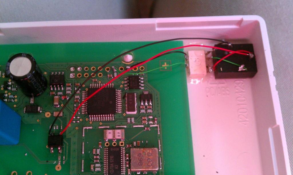

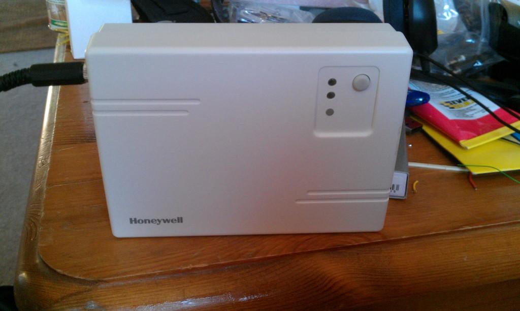

My modification for the HC60NG allows monitoring of the received signals, but no control, as the RF device is an Infineon TDA5210 which is receive only.
The TDA5210 has an RF front end (including a wide range automatic gain control circuit) and ASK/FSK demodulator. The two output signals going to the microcontroller are the data signal and the RSSI (receive signal strength indicator, generated from the AGC). As far as I can see the latter is only used when testing signal strength, with the Manchester encoding being used to differentiate between valid messages and the noise that you see in between valid messages (pinning the RSSI low doesn’t stop message receipt).
The key thing to note when trying to interface the data signal to a PC is the unit power supply. The unit is fed via the classic capacitor/resistor current limiter + bridge rectifier, followed by a 24V zener shunt regulator (for the relay power supply) and an LM317 adjustable regulator for the RF/microcontroller stage.
THIS IS A NON-ISOLATING PSU, AND THE USE OF THE BRIDGE RECTIFIER MEANS THE “GND” OF THE LOGIC CIRCUIT IS AT LINE VOLTAGE. EXTREME CARE IS REQUIRED!
Having said that, all is not lost.
At the top of the PCB are two headers, one 5x2 the other 6x1. The 6x1 header has two ground pins, VCC, the data signal via a 1K resistor and the relay/led signals. This is perfect for driving a sensitive optocoupler. With a typical 1V drop in the led, the 1K resistor gives us a max current of about 3mA. On the RS232 side, the simplest solution is to use a device with logic / totem-pole output and a voltage range sufficient for the extremes of the RS232 level (in theory +/-15V so 30V total, but +/-7V so 15V total is quite typical for most PCs). We can then leech power off the DTR/RTS signal for one rail and Tx for the other rail, with the logic output stage then switching between the two.
Several optocouplers could work, but the TLP558 fits the bill perfectly, having a 1.6mA threshold, sufficient voltage range, operation fast enough for the 38K4 data rate and importantly inverting operation (RS232 using –ve for a 1, so to ensure the data ends up the correct polarity we need an inverting optocoupler).

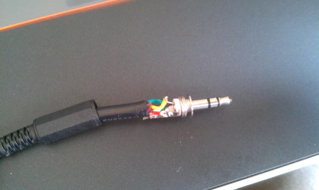

For size reasons I selected a 3.5mm stereo jack for the physical interface to the monitoring RS232 port, with Data at the tip, RTS (could have been DTR is I wanted) on the ring as the positive supply, and Tx on the body as the negative supply. As my laptop has no physical RS232 port I used on of the wire ended USB-RS232 ports from FTDI http://www.ftdichip.com/Support/Documen ... CABLES.pdf .
I fitted the jack at the side of the case, epoxied the optocoupler to the gap between the jack and the PCB, and made the connections using fine insulated wire I had to hand. In the photos, on the PCB side, green is signal, black gnd. On the jack side, red is RTS/ring, black Tx/body and green Rx/tip.
IT IS CRITICAL THAT WIRING IS TIDY AND CLEARANCE MAINTAINED ACROSS THE OPTOCOUPLER TO AVOID EXCITING APPLICATION OF MAINS TO YOUR PC!
The above is the modification as required for monitoring a live HC60NG, but if you have a spare unit then you can also arrange for standalone operation with power taken off the RS232 port. For this you need to solder a couple of extra wires from the RS232 side to the internal side of the bridge rectifier. With the FTDI cable this gives just enough power to bring the unit online and with the FTDI cable effectively gives a USB power CMzone sniffer.
Note, the power connection defeats the Optocoupler isolation, so must _never_ be used with an HC60NG connected to the mains.
Photos of the mods attached.
Colin.

- Connector on FTDI cable
- connector.jpg (55.27 KiB) Viewed 27515 times

Excellent work, can I have clarify a two points. Which version of the FTDI cable did you use the link talks about different versions i.e. 3.3 vs 5 volt etc? If you run the stand alone version with power taken from the RS232 port is the opto isolator still required if so could you post the circuit?
Thanks Kim
Thanks Kim
Re: Evohome / Evotouch Wireless protocol?
I originally used the 5V version (USB-RS232-WE-1800-BT_5.0 http://www.ftdichip.com/Products/Cables/USBRS232.htm ), with the auxillary 5V supply providing power for the optocoupler, but then twigged that the RS232 levels were sufficient, so I swapped to taking power from RTS/Tx. With this change any of the FTDI cables giving true RS232 levels should suffice, or in fact any proper RS232 port on a PC, etc.
When using the RS232 port to power the whole receiver, the optocoupler isn't required for isolation, but you do still need an inverter as the HC60NG uses TTL levels which as the opposite sense to RS232 level. I did try using a version of the FTDI cable which gives TTL rather than RS232 signal levels, but it turned out that direct application of 5V to the receiver circuitry didn't work (I suspect the regulator misbehaved when there is power on the output but not the input) and the voltage drop in the regulator means that application of 5V to the regulator input doesn't work either. So overall it is better to stick with RS232 levels and use an inverter, optocoupler or otherwise.
In terms of the "circuit" the photos say it all:
* RTS or DTR provide your positive supply
* Tx provides the negative supply
* If using the recommended optocoupler, +ve goes to pins 7 & 8 (+ve & enable), -ve to pin 5 (Gnd) and Rx to pin 6 (output)
* On the "internal" side, pin 2 of the optocoupler connects to the signal on the PCB (see green wire), pin 3 to the PCB ground (see black wire)
* If using leech power for the receiver (i.e. standalone) add the two extra wires shown from +ve & -ve to the inside of the bridge rectifier.
Hope that helps, but happy to answer any questions.
Colin.
Colin.

Colin
Thanks for that, I understand the RS232 level thing for the power. I was assuming that the RX data on the HC60 would be ttl level and therefore wouldn't drive the 232 FTDI cable correctly.
For the software how does it pick up the description of the HR80's Dinning room etc? Do you have to edit the source? I'm in the UK any idea where to pick up the opto coupler?
P.S Forgot to add I'm looking at a BDR91 relay box which is a later version of the HC60, It allegedly can transmit and receive possiblities for control....
Forget the part about the TTL HC60 signal driving the 232 cable, the opto isolator takes care of that. I'm on a Mac any idea when you will post the source? Thanks
The descriptive text comes from the system data file. Initially it is written with numeric names, but you can edit to meaningful values and these are used at the next program start.
