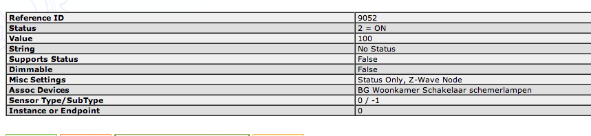

certainly strange: I've clipped my additional info of the root device: it doesn't support status?!
I've found a work around, thanks to you: when I manually operate the switch, the log file reports a status change of the root unit, but home seer status isn't changed.
I've created two events, based on the status of the root unit, which in turn changes the value of child switch 1.

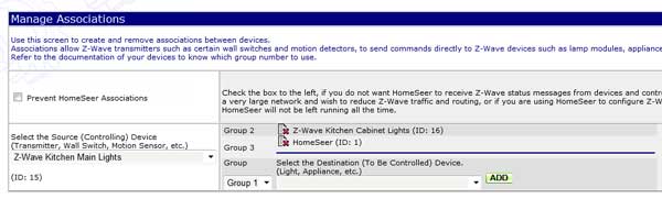

Originally I had a second on / off module associated to Group 1 of the dimmer and Homeseer associated to Group 3. This worked fine. When the dimmer was switched the second module was also controlled and the status was automatically updated in Homeseer.
I wanted to move device 2 onto my second switch to make it independant of the main lights, so I removed the association to Group 1 and added an association to Group 2, however module 2 does not appear to respond to switch 2 on the dimmer. I have also tried associating other on / off modules to switch 2 but again they do not respond.
Does anyone have association working on Group 2 with the Fibaro dimmer?
I have attached a screenshot of my Homeseer association setup for this device and also a diagram how I wired the 2 momentary switches. I assume this is correct as the manual does not actually show the connections in detail on the switch side.
Anyone have any ideas? I am new to Z-Wave, so maybe I am missing something obvious.
Thanks.

Scooty, maybe stupid question but did you enable the second switch on the dimmer ?. By default this one is off. You can enable is with parameter 17.

Reading the manual does not suggest to me that this would enable switch 2, but still I gave it a go.
Parameter No. 17 - the function of 3 - way switch, provides the
option to double key no. 1. The Dimmer may control two
bi-stable push-buttons or an infinite number of mono-stable
push-buttons. default value 0
Options for changing parameter 0-1
0 - the function of 3-way switch is disabled
1 - the function of 3-way switch is enabled
Setting parameter 17 to 1 with my setup makes switch 2 do exactly the same thing as switch 1. It just switches the load attached to the dimmer but the association to group 2 still does not work.
I sent an email to Fibaro in Poland yesterday and they replied saying that associating a device to group 2 should just work wihout any special configurartion changes. They are sending me a replacement dimmer in case the unit is faulty. I only have the one dimmer so I cannot test another unit.
It may be that the problem is caused by the way that Homeseer applies the association but I do not have another controller to try it with. Perhaps someone with a Vera or other controller and a Fibaro dimmer may test group 2 association on a second switch. This way I suppose I would then know if it is a module or Homeseer issue.

Today I received a replacement dimmer module from Fibaro and I can confirm that the problem with associating a device to group 2 was in fact a defective module and not a problem with Homeseer. It is working fine now controlling a second on/off module from switch 2.
Not sure if it is relevant but the serial number of the replacement unit is 0003 0885. The old unit that did not work with association on group 2 had the serial number 0002 3849.
Looking at the format of the serial numbers maybe the first part is a batch reference and I have gone from batch 2 to 3.
