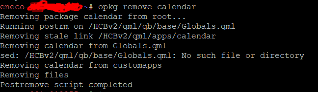

I do the following
First:

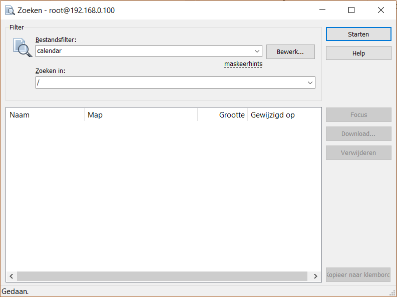

Remove Calendar with opkg remove calendar and search with WinSCP on Calendar, for the not removing files. Give me this result
Putty:
WinSCP:

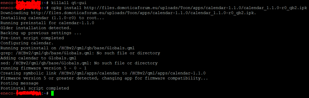

This one looks good, so give Toon a restart of the qt-gui with: killall qt-gui
When Toon is back online, i install last version of the Calendar with: opkg install url-to-last-version-of-Calendar
Putty install Calendar:
So i did also now a qt-gui restart, because Toonstore does this too.

So here it goes wrong, but I would not know where it would take that backup. As you can see, WinSCP does not find anything at all anymore.
Sorry for the long story, but just wanted to explain how I removed it and how I installed it again.
