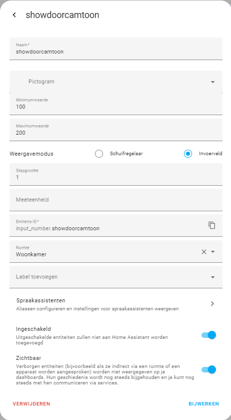

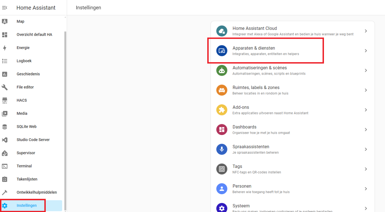

2. Go to HA and create a new Helper:
Go to Settings/Config then to "Devices & Services":
Next to "Helpers":

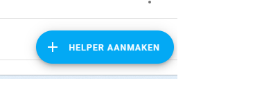

3. Add a new Helper by pressing the bottom (bottom right side) "Create helper:
4. Complete the form for the new Helper:

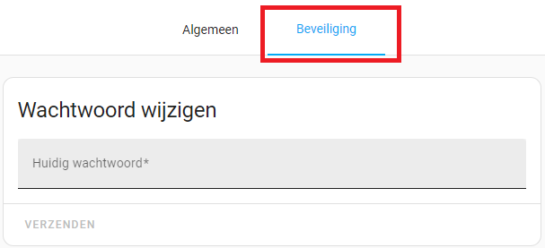

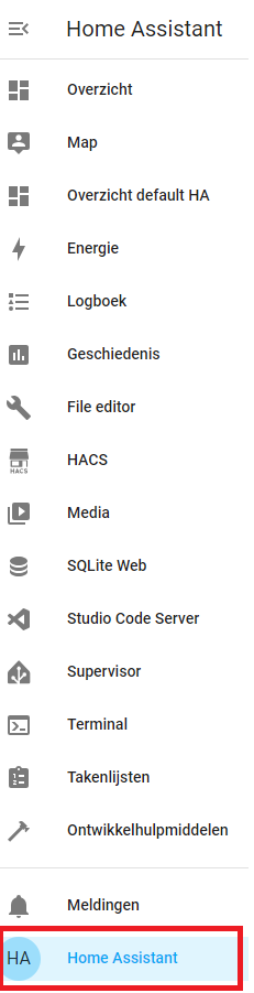

5. Now we need to create a "long lived access token", Go to your user profiel on the bottom left:
6. Go to "Security":
(Instruction continues in next post due to limitations of adding screenshots)

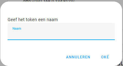

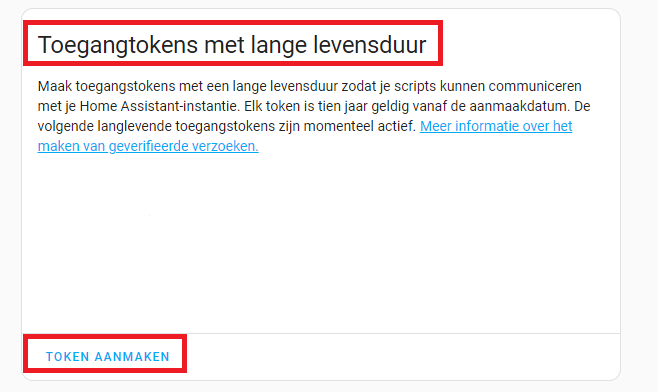

7. Scroll down to the bottom untill you see "long lived access token" and click on "Create token":
8. Enter a name for the token and click Ok:
9. Copy the token and paste the token for example in Notepad++ (and make sure to store the token, the token is only being created AND showed once!)
