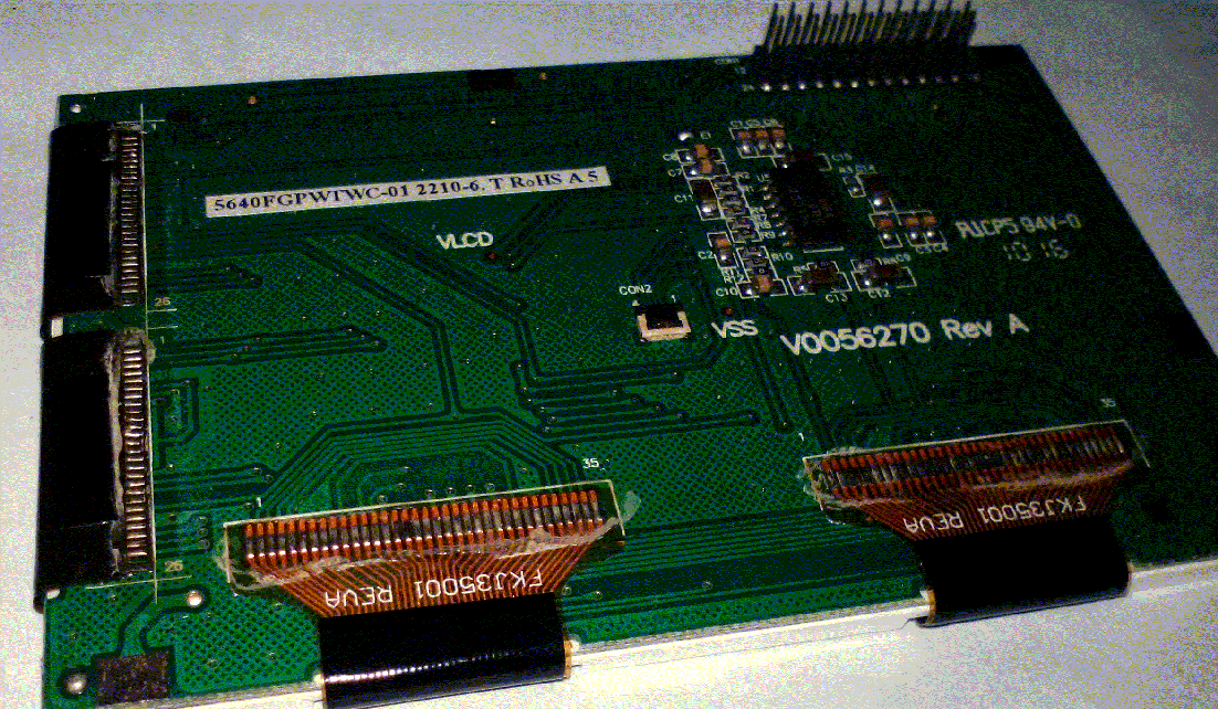

hi, I try lcd screen as photos. the device wirelles for parts to control temperature evohome / honeywell. if someone has to spare please contact andrea@ilsentierone.it Oggeto email put in touch evohome
behind the photo exists lcd
thank you very
