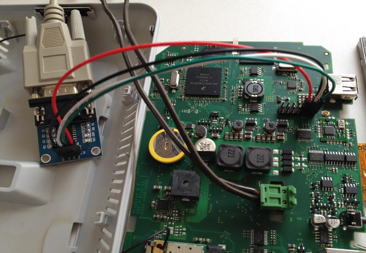

can I just use an older laptop with a serial port with direct wiring of Rx, TX and GND? Or are the voltage levels different?
It's a 3.3V signal level serial port, so no. Wouldn't try to put proper RS232 signal levels on that port.
It should, specs state that it's a 3.3V device. I'm not very fond of this particular chipset, but that's a matter of taste.
Can someone attach a photo of the connector side just to be damn sure about this and not screw anything?
Nope, after more than three years on this forum I still have no clue how to upload pictures and make them visible in a post. Sorry about that.
The good News is that pin 1 on the 14-pin connector is marked with a 1. The same row of 7 holds all the odd pin numbers, counting up monotoneously. The other row starts with pin 2 next to pin 1 and counts up in the same direction as the odd row. Make sense?
I'll give it a shot. I mean, how hard can uploading a picture be? At least it shouldn't be more difficult than hacking a Toon :wink:
Toon console connection
I admit it's not the clearest picture, but along with the description it should give enough confidence to proceed.
Can't say that I tried very hard 8)
