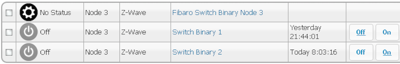

When I manually switch 'switch-1', in HS3 'switch-2' goes to ON?
HS3 (latest)
Fibaro relay switch 2x1.5kW
Aeon Labs Gen-5 stick
> when I click ON for "switch-2" I hear the relay but nothing is connected
> when I click ON for "switch-1" the lights are turned ON
Now everything is turned OFF
fibaro switched off
fibaro switched off
> when I flip the switch that's connected to S1 & Q1, the lamp is turned ON but
in Homeseer DEVICE "switch-2" gets status ON, not device "switch-1"
fibaro switched ON
fibaro switched ON
Any idea why that happens? Nothing is connected to the Fibaro ports S2 and Q2.

I`m running HS3 Pro Edition 3.0.0.194 (Windows) with a UZB stick and you are absolutly right. I have several of the dual-relays (NOTE: FGS-221) and when i switch the overloop button the inloopkast becomes ON. But when i switch the inloopkast butten the inloopkast becomes on. It looks like something went wrong in a new update.
Did you noticed it is possible to upgrade the firmare on the root device. I just found out the new button
Changing the end-point does not make any difference

Added another dual-relay module (Firmware 22) and it is also affected bij the bug. Both buttons are updates as S2

I just dusted off a RaspberryPI and tested using Domoticz and the device is working fine. When i switch button 1 device 1 is updated in Domoticz and if i switch button 2 device 2 is updates.
