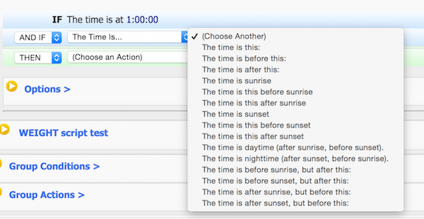

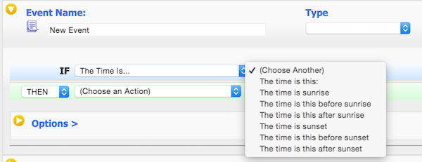

In HS2 I was able to create an event that had 2 conditions
- time after 01:00 AND time before 07:00
Another event would run this event "If other event conditions are TRUE"
In HS3, I cannot start the event conditions with "IF time AFTER". There's only on/after sunrise conditions.. Why is that?
First "The time is" condition
First TIME IF condition
Screen Shot 2015-10-04 at 11.17.44 .png (75.22 KiB) Viewed 9625 times
Q: Why can't I use "Time After x:xx" as the first condition?
"AND" "The time is" condition
AND TIME IF condition
Screen Shot 2015-10-04 at 11.18.19 .png (173.97 KiB) Viewed 9625 times
NOW I can select "Time After x:xx" ?
Any workarounds? Tips?

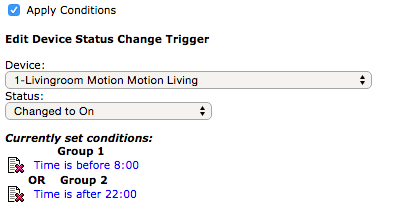

For example: An event that is triggered only between 22:00 and 08:00
Event conditions
Event conditions
Screen Shot 2015-10-15 at 16.13.22 .png (29.67 KiB) Viewed 9189 times
In HS3 if I do a
............ IF motion livingroom
............ AND time is > 22:00
............ OR <condition>
Now my only choices are
Event conditions HS3
Screen Shot 2015-10-15 at 16.16.22 .png (29.06 KiB) Viewed 9189 times
It feels like I have missed a basic "HS3 thing"... Any idea?

I think you need another AND IF instead of OR IF.
