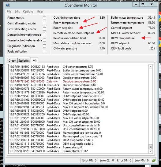

Re: New Google Nest has Opentherm
Hi Schelte,
logfile is uploaded
see below that the OT monitor does not pick up 4 sesnors from the Google Nest V3
Outside temp is filled, this is coming via the Nest which gets it from Internet
Afbeelding 25.jpg (147.79 KiB) Viewed 22170 times
Posts: 2035
Thanks. So the Nest indeed doesn't report the room temperature or the setpoint. It also doesn't poll the DHW temperature. (You can add that as an alternative so the OTGW will obtain it, if you like.)
The outside temperature shown on the OTmonitor GUI is not provided by the Nest. Curiously (since you say it doesn't use it) the Nest polls for it and the OTGW then returns the value you have set at some point.
