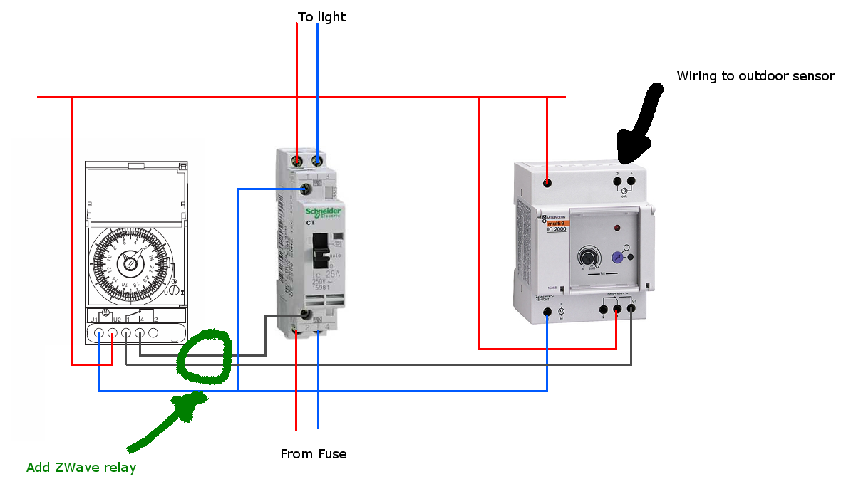

A picture says more than a 1000 words ...
Schematic
Schematic

I would do it this way:
  • - Outdoor sensor > input 1 of Fibaro Relay
    - Output 2 of Fibaro Relay > Lights
    - Remove clock module
You create this logic on your controller (homeseer, fibaro HC, domoticz, Homey, etc):
  • > When Input 1 AND time is nighttime Then Output 2 on for x minutes
    > etc.

I woudln't be that interested in knowing the input status, as it automatically switches on the lights ... or not ?
Or are they 'the same' (input AND output) ?
