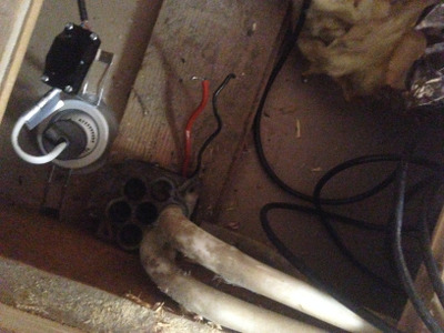

Ok, I did have a look at the scheme you referred to. As you can see on the picture attached, I only have two (old) wires, near the light bulb and no blue or brown wires nearby. So how to connect the wires to the module? Or do I need a blue wire somehow?
Wiechert.
Akatar
Posts: 1135
Location: the netherlands
Re: How to automate in an older house?
Post by Akatar »
i guess red is the blue wire (neutral)
you need a green wire (fase)
https://nl.wikipedia.org/wiki/Sjabloon: ... nstallatie
so you need a green wire, or use the black wire as fixed (connect the two wires behind the wall switch and use a couple of wall transmitters to switch the module

Ok, thanks for the colour scheme. I will try to find a (Brown) wire form an wall-plug on the attic and try to use that. Since I need to keep the "hotel switch" working. Give it a try tomorrow lets see how it ends up :)

with multiple wireless wall transmitters you have the "hotel switch"with as many swithes as needed
i guess you need a green wire, from the same als as the red one (aardlek)
