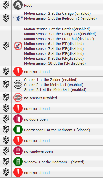

The logging to a virtual device looks like this :
