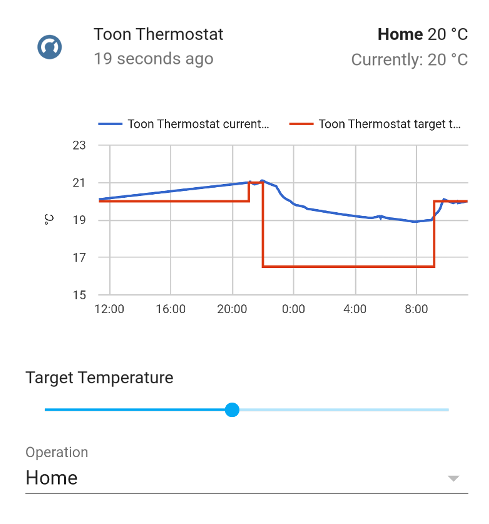

I coded a small custom component for home-assistant so you can directly control/query your rooted Toon from inside your network.
https://github.com/cyberjunky/home-assi ... components
Regards, Ron.
