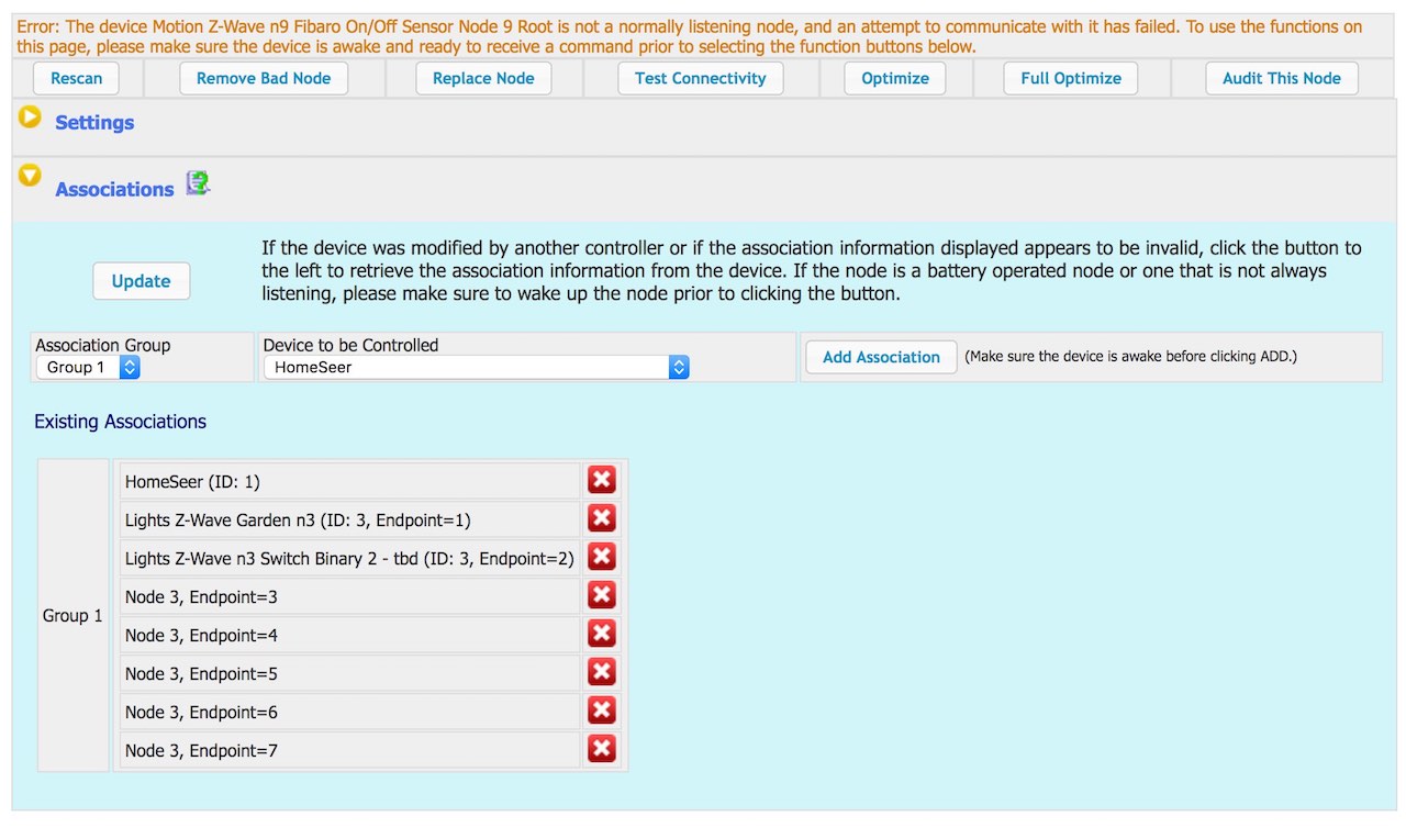

Hmm... Finally was able to wake up the Fibaro Motion sensor in HS to find out that it had a huge list of "Associations" ??
I was able to remove some of these associations, but the ones below can't be removed.. (?)
HS Fibaro Motion Zwave associations
Screen Shot 2017-06-14 at 9.16.17 .jpg (141.01 KiB) Viewed 6916 times
Another motion sensor (same type) doesn't have any associations.
