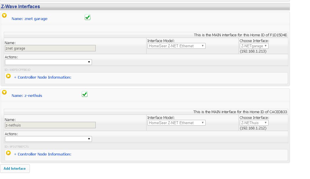

i use 2 of those, but i am running hs3 on a server not on the device itself

You need the znet for pairing, i have 2 units with 2 zwave networks. i have to pair it with that unit who is going to control the device.

eh, you mean the two devices do not interchange data of the clients?
** edwin **
Akatar
Posts: 1135
Location: the netherlands
Re: does anyone tried HomeSeer Z-NET Remote Z-Wave Interface
Post by Akatar »
not on my setup, i did chose for 2 seperate zwave networks
