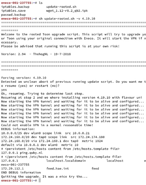

Hey. With the forcing it is still waiting for VPN to be alive. See the screenshot.
Thank you :)

MadDemonoide wrote:Hey. With the forcing it is still waiting for VPN to be alive. See the screenshot.
Thank you :)
Just keep trying a few times. had that once before too.

I think you have a very old version of Toon firmware which doesn't update the /etc/hosts file properly (your feed.hae.int entry in your hosts file doesn't match with the routing table)
Try to remove the "feed.hae.int" line from the /etc/hosts file and restart the Toon and the script again.
