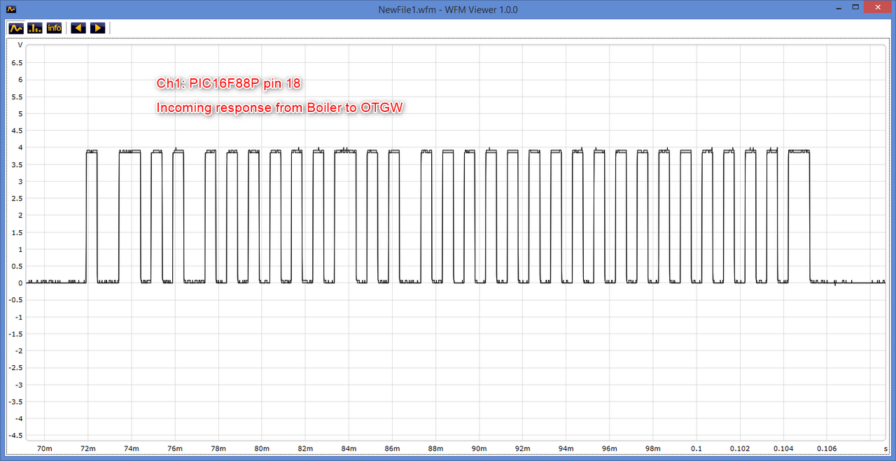

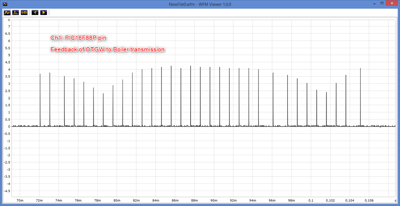

As presented on the attached waveform (OTGW425_to_Boiler_Tx_feedback.png), pulses are not as specified in the "Opentherm Protocol v2.2", chapter "3.4.2 Bit Rate and Timing".
Second waveform (OTGW425_Boiler_Response.png) presents response from Boiler.
Although it works, is it possible to be fixed in the OTGW firmware? Very short pulses produces EMI incompatibilities and shall be avoided.

It is unclear to me where you observed those spikes. But if you can improve the OTGW, I'm all for it. The 4.2.5 sources can be found on the OTGW download page.
