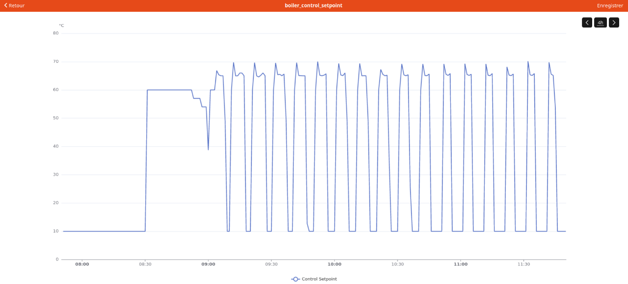

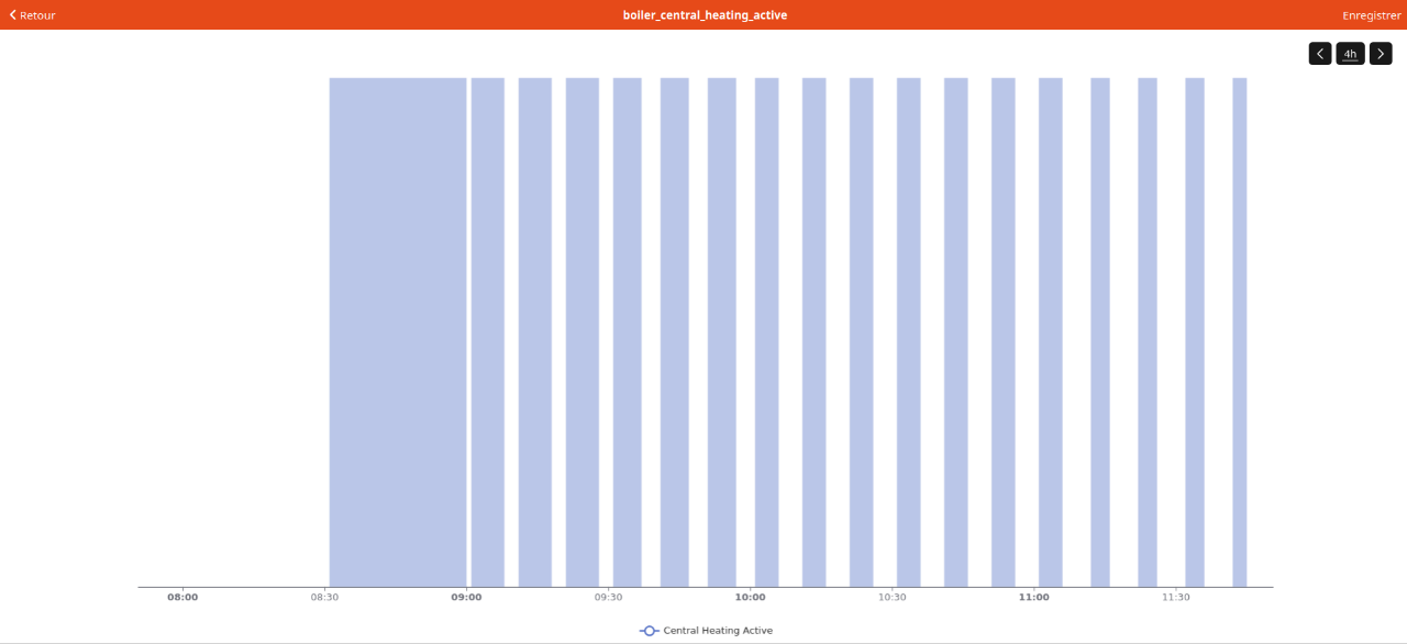

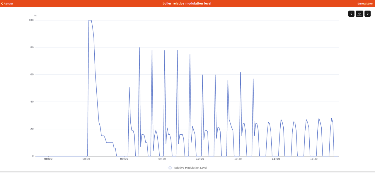

Oh and there's also the fact that my current thermostat seems to be quite dumb and not doing a good job at modulating my boiler:
