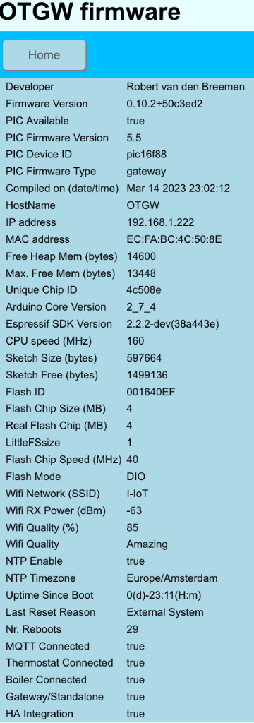

Anyway, the random reboots still continue. 29 times in the passed two weeks. I can't find a hint of what's wrong in the log-file. The reboot system says that the last reboot reason is "external system". So maybe it is the NodeMCU loosing connection, I don't know.
Configuration is in screenshot. It is connected to a Remeha Calenta 40L Central Heating system. Besides the reboots the system responds well to the OTGW control.

Posts: 2035
Re: Setup of otmonitor.conf
Those are reboots of the ESP8266. But "External System" means a hardware reset. Someone pressed the Reset button on the NodeMCU?
