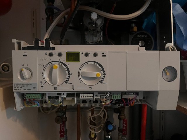

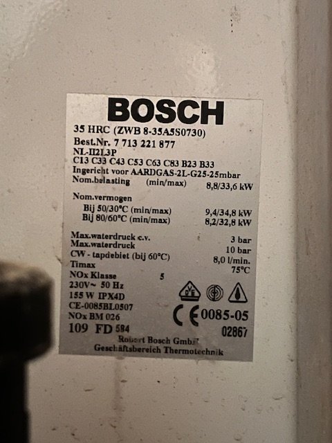

Thank you for your responses !
I tried finding a manufacturer indication on the board, but I hesitated dissasembling the casing, as I wasn't sure how to do that properly.
For what it's worth attached are photo of the specification sticker inside the boiler, and a photo of the semi-dissassembled panel.
I took the "risk" and order the OTGW anyway, so in a few days I can post some details (and upload the log files).
If it doesn't work, I'll be glad to follow Kermit's hints how to homebrew some temperature monitoring

received and installated the OTGW successfully !
uploaded the capability log file.
Return temperature etc. are unavailable, but a few useful parameters are : boiler water temp, and boiler water control setpoint.
