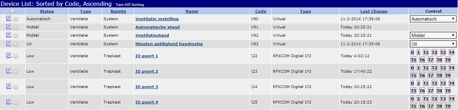

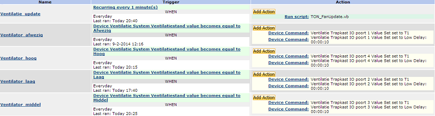

A while ago I promised to share my scripts for controlling the ventilation.
Recently I optimized my solution, so now its time to show.
See the following script with the corresponding homeseer devices and events.

Homeseer ventilation devices
Homeseer ventilation events

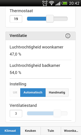

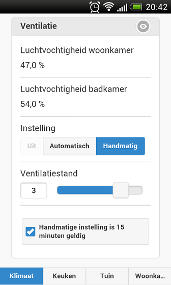

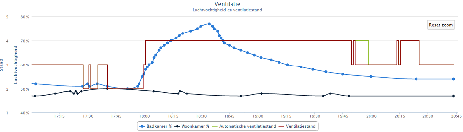

I control HomeSeer through my own HTML5 app using jquery mobile:
App ventilation (auto)
App ventilation (manual)
App ventilation (chart)
