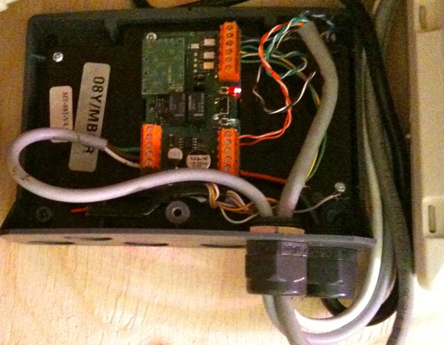

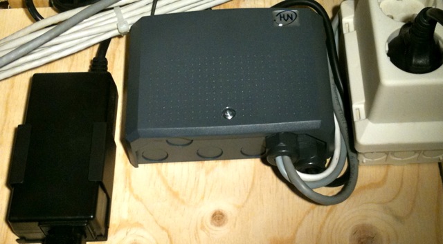

The controller:
The inside of the controller unit
The outside of the controller

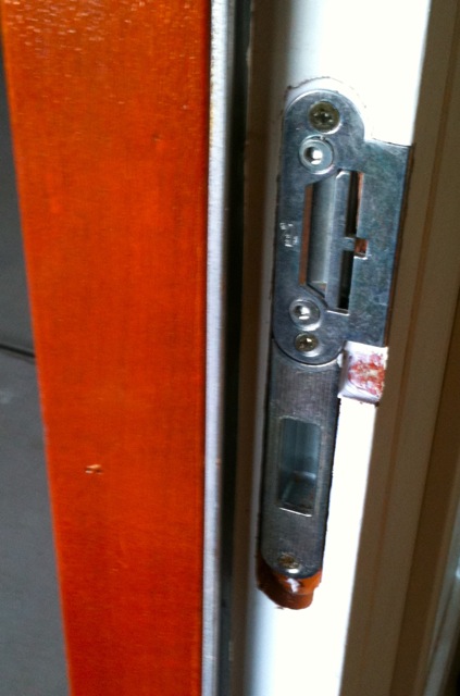

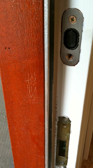

The locking plates and sensor:
Main plate
Main plate
Magnet/sensor and bottom plate
