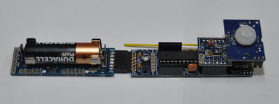

After a lot of testing i can't get my jeenode with roomboard working in homeseer.
First:
- i used Jeenode_for_homeseer.pde from (Domotica Workshop\Software\HomeSeer\Workshop\JeeNode)
- my config of the ports looks like:
#define PIR_LDRPORT 1
#define LEDPORT 0
#define SHT11PORT 4
- my roomboard is above the rf chip (see attached picture)
with this configuration the temp and humi is displayed perfect, but move and light didn't work, light always 251 and no move. When i turn around my roomboard and changed the ports to:
#define PIR_LDRPORT 4
#define LEDPORT 0
#define SHT11PORT 1
then the light and move works perfect, but no temp and humi.
How's that possible?
I also checked if i can use port 2 of 3 instead of port 1, but same result, only port 4 works good,
#define LEDPORT 0
#define SHT11PORT 1

Re: Jeenode only port3 works?
Keep the config of the ports as provided (LEDPORT 3 is better than 0!) and room board orientation as shown on the picture.
9-12-2010 23:58:29 - JeeData - 1,2,0,251,38,217,
9-12-2010 23:59:44 - JeeData - 1,2,1,251,38,216,
I see a move there, watch the underlined & bold 0 and 1 values.
Hitting refresh in the HS status page won't work to check, too slow...
Tip: add an event to the move, you'll see it does trigger!
That's the only way I managed to test the PIR accurately.
Regarding light:
Put a black box or something else that blocks light over the room board.
Wait a while. Still no difference?
Thanks for your answer.
I uploaded the original sketch to the board with the right port settings as you wrote above.
Yes sometimes i see movement in the log, but the light is always 251. When i put a blackbox over it i see only movement (from 0 to 1) but light gives 251
I checked my board with the original roomnode sketch and play with the light dan then it looks like it works, dark = 0, very light > 200.

Re: Jeenode only port4 works?
So the problem was the jeenode.
I created a new one with the same roomboard and now its works. So there is a problem on my original jeenode made at the workshop. But i checked and double checked everything, but cant find a reason why only 1 port works.
Anyone an idea?
Ow yes and on my new jeenode dark = 255 and light = 0.
