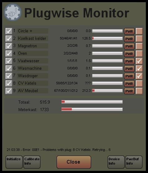

Source seems to have the same problems like I do with my own code. I guess my living space is too large. For example I had to sacrifice the Circle+ to do nothing but sit in a wall outlet just to cover the space between the PC and the kitchen where most of the circles are. I also had to reposition the USB stick a few times to get a good connection.
As you can see in the attached image I can enable and disable circles. A disable means that it doesn't get polled. I can set another radio button which enables the alarm to switch the selected circles off when armed and on when disarmed. I put a power threshold in the loop to check if a device is still in use. So the checked power needs to be below the set threshold for the alarm to be able to switch a circle off. If the threshold is set to 0 a circle simply cannot be turned off. Handy in case a circle powers the domotica PC. Switching would kill the setup;)
I guess more circles will make it better but in my simple case one less circle in the cellar makes it better.
If what you suggest is true, the Source software stores the correct route in the circle (+)? I have seen messages pass by where the macaddress of the circle + and another macaddress is in the same message. Maybe that's where a route gets set. Also when searching for new circles a message loop 0018circle+mac00 - 3F is issued and the replies followed present all FF's. Maybe there the complete route is reset and rebuilt. Lot's to learn I guess.
- plugwise.JPG (35.96 KiB) Viewed 14252 times
