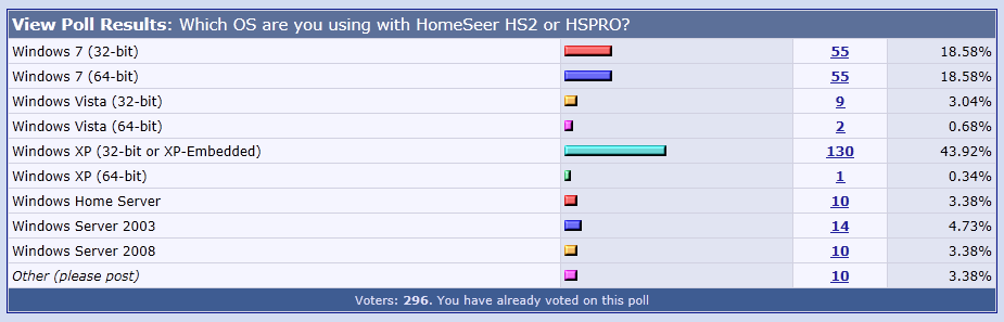

Update, this is a poll that I just found on the HS board.. It can give you some indication of what is being used..
Windows 7 seems to be second (adding the 32-bit and 64-bit percentages which happen to be exactly the same??)
- Homeseer OS poll
- Screenshot-2012-01-21_17.49.31.png (28.38 KiB) Viewed 6741 times
