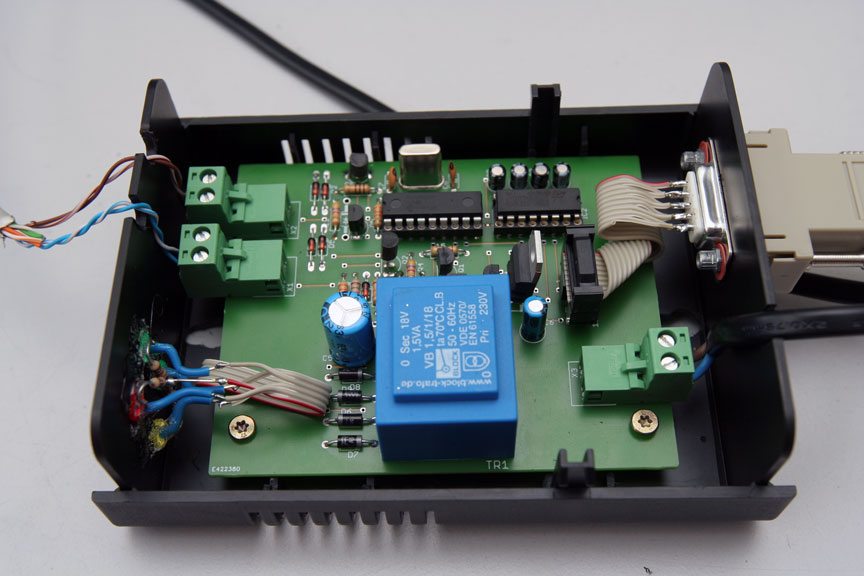

My gateway has been running stable now for a week so it's time to round things up and mount it on the wall.

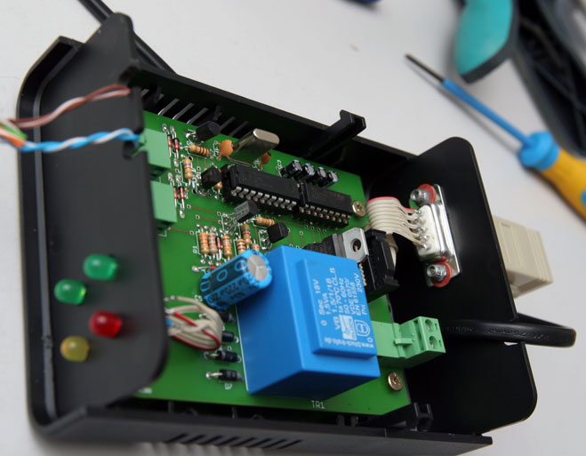

4 Status leds
4 Status leds
Gateway in its enclosure. Leds glued.
LEDs side view.
LEDs side view.

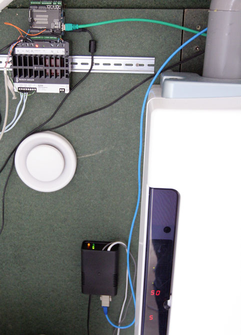

Gateway + Intergas
Gateway + Intergas
Red = Opentherm Error
Yellow = Flame ON
Green / Green = Opentherm Messages
