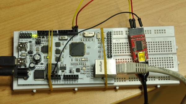

Wanted to show you the latest thing I'm working on right now. It involves a lot of things I've never done before, so to me it's very exciting.
Since a week I'm logging the P1 port of our smart meter that was installed 6 days ago.
For that I had to place a laptop near the smart meter, so that's not really good as permanent solution :)
And because it was time for something completely new, I decided to use a Simplecortex this time:
Simplecortex
Simplecortex
The status right now is that the Simplecortex can (almost) be connected to the P1 port and it will send the P1 data over its Ethernet connection for further processing.
But that's not all, I'm going to use this Simplecortex to transform my smart meter into a messaging client.
Although I'm not there yet, the results sofar are promising.
If you'd like to read more, try the smart meter and Simplecortex link.

Right now my system is a monolithic executable that does 'it' all; not that good and not flexible; I'll never be able to run parts of the system on several pieces of hardware (NAS, router, you name it). This is my first attempt to move processing of the raw data away from that single executable; instead of exchanging raw data, now only data that really means something will be published. Other parts of the system that need that information can subscribe to it. Goal: a distributed, more flexible and robust system. Hmm, this can become a long story and in fact I already wrote about it before, here:

I will. The next thing on the list is making the TCP/IP connection a "self-healing" one, in that it will recover from network failures automatically.

Today I reached the point where the end result could be tested: smart meter P1 data being published to a MQTT broker and any number of arbitrary clients subscribing to it:

Today I "installed" the Simplecortex near the smart meter, connected it and it started publishing to the MQTT broker.
