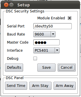

I'm very new in Domotiga and would like to test the DSC Interface.
I've own a Power panel with PC5401 working.
After Domotiga install and initial setup I could see my alarm zone devices with their real time status (open, closed).
I've tried to send Arm command but nothing hapend.
Where is possible to configure the mastercode? Is it already working?
DSC send command

It should be working, you can set the mastercode in the DSC settings form.
If you can't get it to work enable it's debug setting, try your thing and sent the debug log output (offline, see e-mail address in DomotiGa's README) and I will see if I can find something.
See attachment.
See attachment.
- dsc settings.png (24.54 KiB) Viewed 3672 times

I've changed for the IT-100 interface and now it is working.
I've also change some code to disarm the panel:
in the : PUBLIC SUB btnEnter_Click()
I've need to put this line of code after the sub declaration:
IF Len(sCode) = 4 THEN sCode = sCode & "00"
