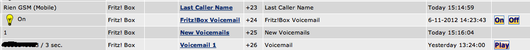

Hi Robert,
See attached image. I still have this strange behavior that date/time of the voicemail device code is more than a day earlier than the actual recording of the voicemail or incoming call. Can you explain this ?

Digit wrote:Rien,
Does the Fritz! Box have the right date & time? Please check it.
Cause I set the Lastchange to the DateTime stored in the Fritxz! Box DB.
You can also check if the datetime field in the Access DB (which should be equal to the one in the Fritz! Box DB) corresponds with what you see.
If that's not the case, create a new voicemail while in debug mode and send the log to me.
I'll have a look in the weekend.
It was a bit odd, because the Fritzbox logs showed the right date/time, but the call list was about 26 hours different. I found this article on the internet http://service.avm.de/support/en/SKB/FR ... -call-list which corrected the problem.
So this is no plugin issue, sorry for that.....
